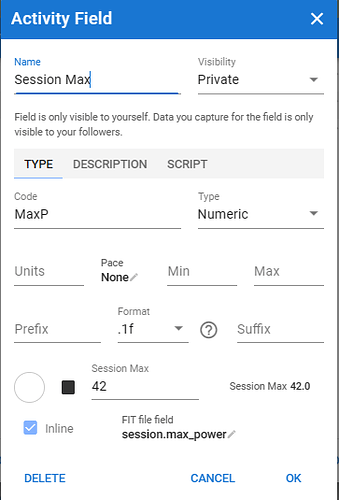

Go Custom > Add field > give it a name > then in FIT file field put lap.max_power > save > ok > close > actions > reprocess

Solution: If you have max power on the session section of your fit file, just create a custom activity field for it. If not, you need from @david to get the greatest value of the max power from the laps.

Have I that field filled correctly? session.max_power
Have you reprocessed the original FIT file?
I have. What I haven’t done is delete and reupload which I might do now actually
Yup. That worked. Deleted the file and after re uploading it has changed the session max to 999
