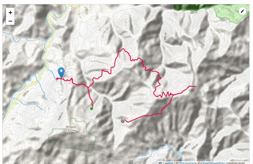

this gives me GPS points for my outdoor rides, works ok. but for Zwift rides the response is empty.
The map is visible in intervavals.icu activity page
and the activity is imported in intervals directly from Zwift (and also Strava)
Am I missing something? maybe the GPS track comes into intervals only from Strava and not Zwift so per Strava policy is not forwarded via APIs? :thinking:
Post hidden. I was getting an empy json/array, I don’t know why but now it works… :man_shrugging:
