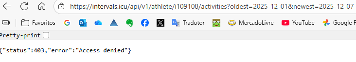

I’m trying to access my own athlete data via API using Basic Auth (API_KEY:my_key), endpoint
https://intervals.icu/api/v1/athlete/109108/activities?oldest=2025-12-01&newest=2025-12-07
but always get 403 Access denied.
API key and athlete ID are correct.
Has /activities been restricted for personal API keys, or is there a new way to fetch workouts?
Is it really 109108 or is it i109108? I bet it‘s the latter.
both comes with the same error result
Nevertheless, you don‘t need the athlete id for this endpoint, you can use 0.
https://intervals.icu/api/v1/athlete/0/activities?oldest=2025-12-01&newest=2025-12-07
If you still get a 403 error, double check your API Key.
yep - still getting an error with this URL - what should I check with the API Key? I created one, and regenerated like 3 times already :frowning: (tks for replying btw)
Do you try this in browser console? (Your screenshot looks like that)
If so, I am not sure, if that works at all, I think the browser only sends tokens from cookies, but not sure about this. You could check, if the header was really sent.
Did you try it on this page, there you can „play“ with the API
(You can authorize before using it at the top of the page)
Did you try 'API_KEY':my_key? The „user“ should be a string
this actually did the trick THANK YOU! :slight_smile:

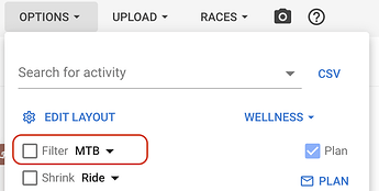

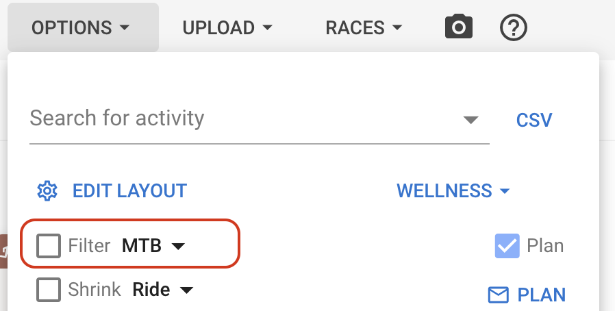

I can see it (Monday). Maybe a temp network issue? Or do you have any activity filtering active?
I manually uploaded the activity. However, syncing with Garmin is now working properly. Thanks.

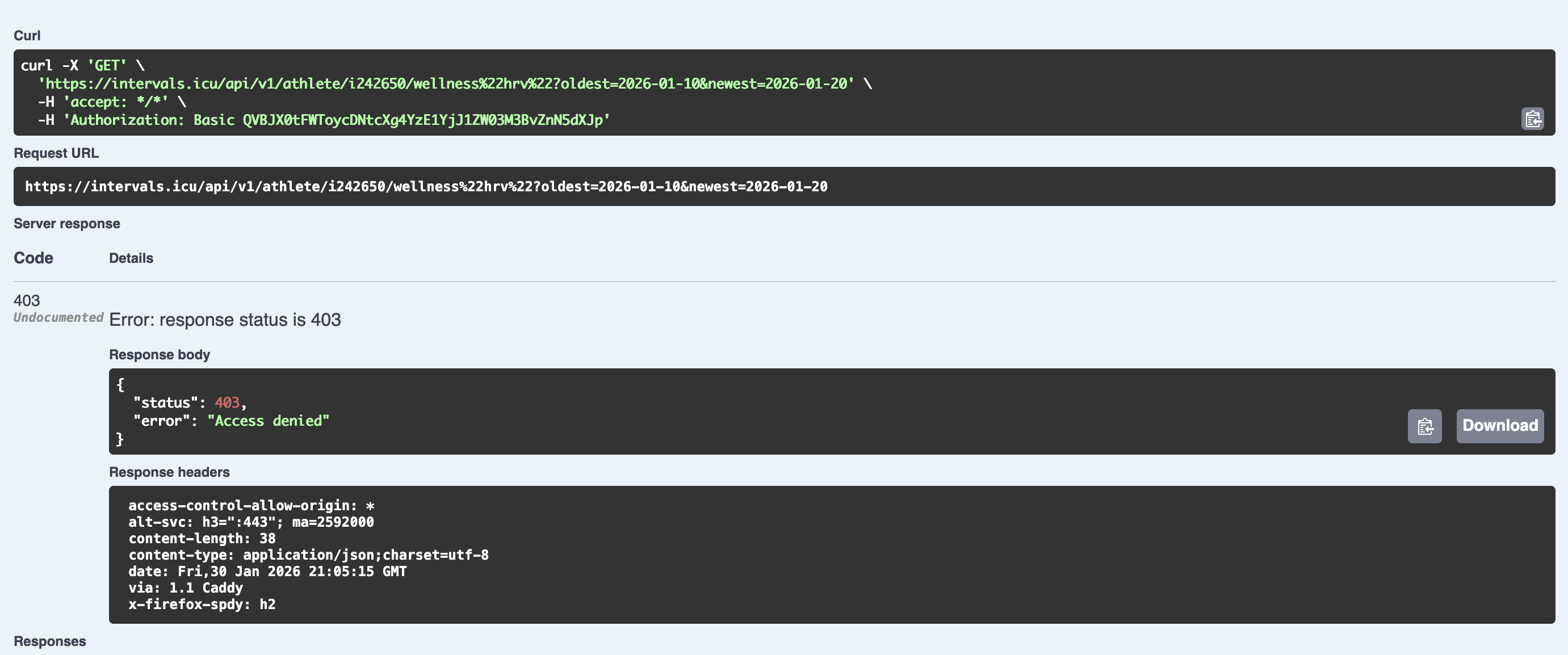

Hello, I’ve been trying to upload values to bloodGlucose and custom wellness fields, but I keep receiving 403 errors. This is the first time I have worked with any sort of API calls so I’m not super sure what I’m doing either. Using SwaggerUI I get 403s and I have no clue why. I have reset the API key multiple times, once it worked for about 10 minutes, but shortly after it stopped working again. Could anyone help me with this?
The key in the curl response is not the key I’m generating each time, but for some reason it did work a single time.
