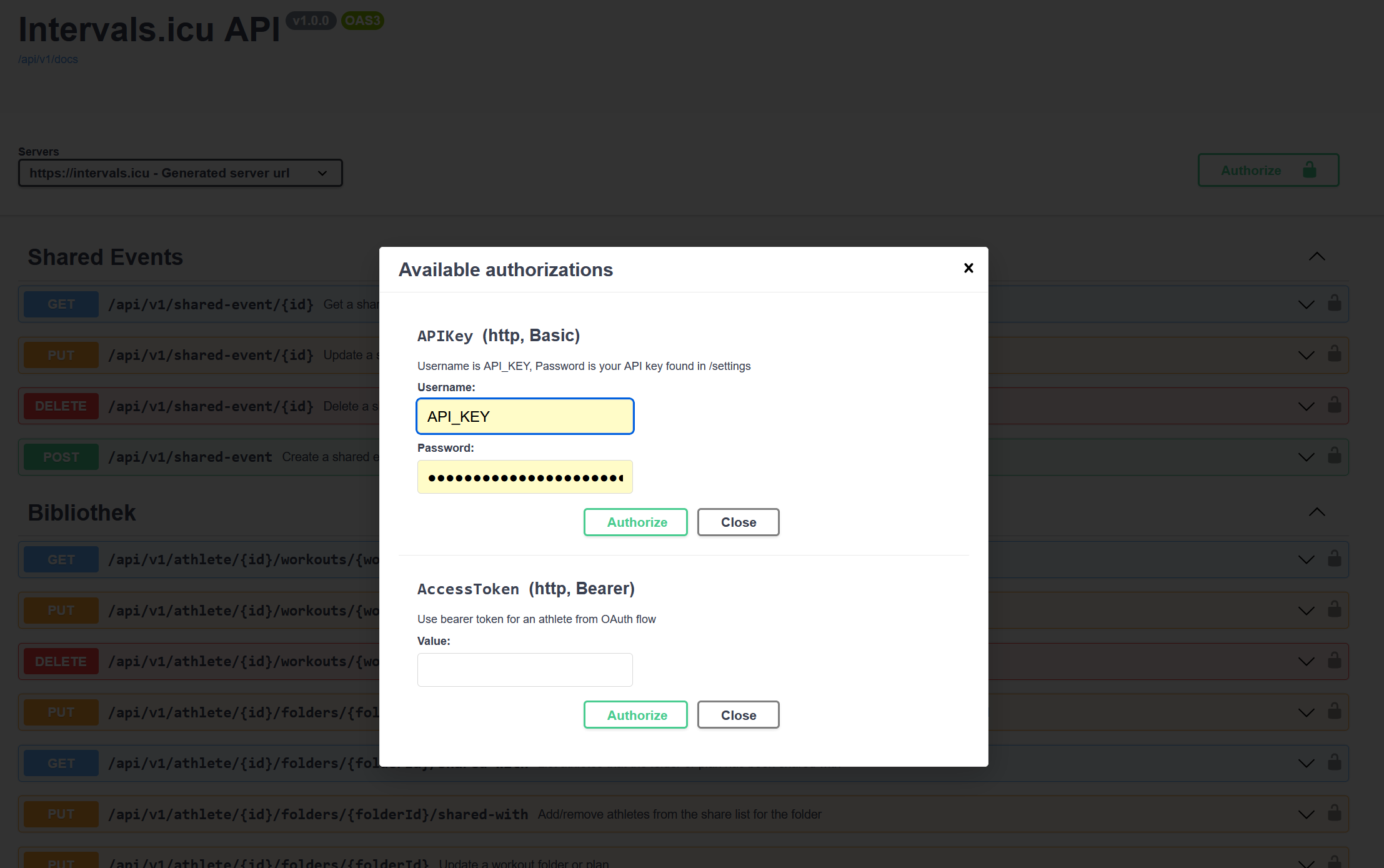

You almost certainly made the ‘usual’ error…
To acces the API, the username is the literal string ‘API_KEY’ (AND THUS NOT your api or athlete id) and the password is your personal Api-key.
If not, post some examples of your curl commands.
Should look like
curl.exe -u API_KEY:8765abcd3432s2u3h3tyhmnof https://intervals.icu/api/v1/athlete/i6789/wellness.csv?
The user name is ’API_KEY’ with basic auth.

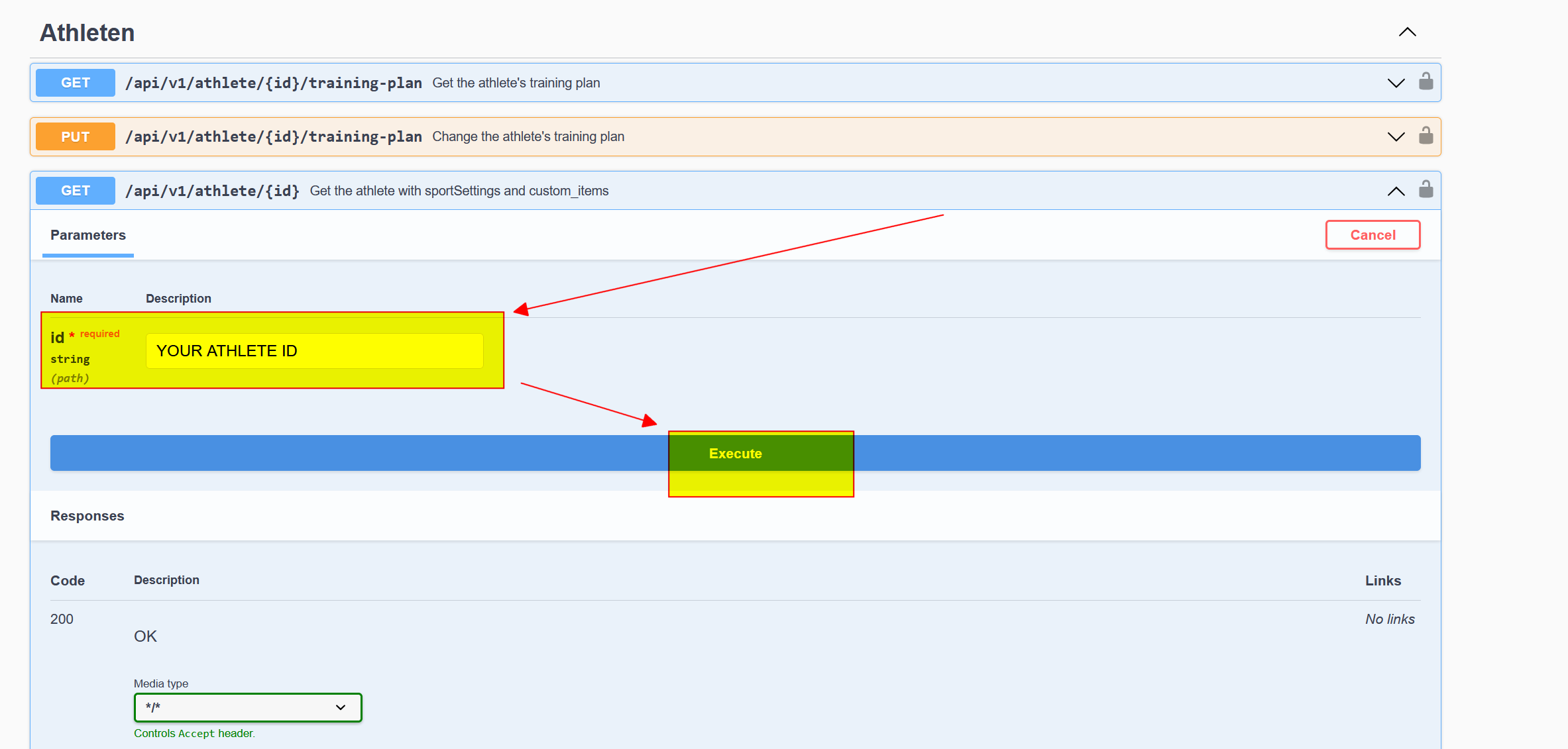

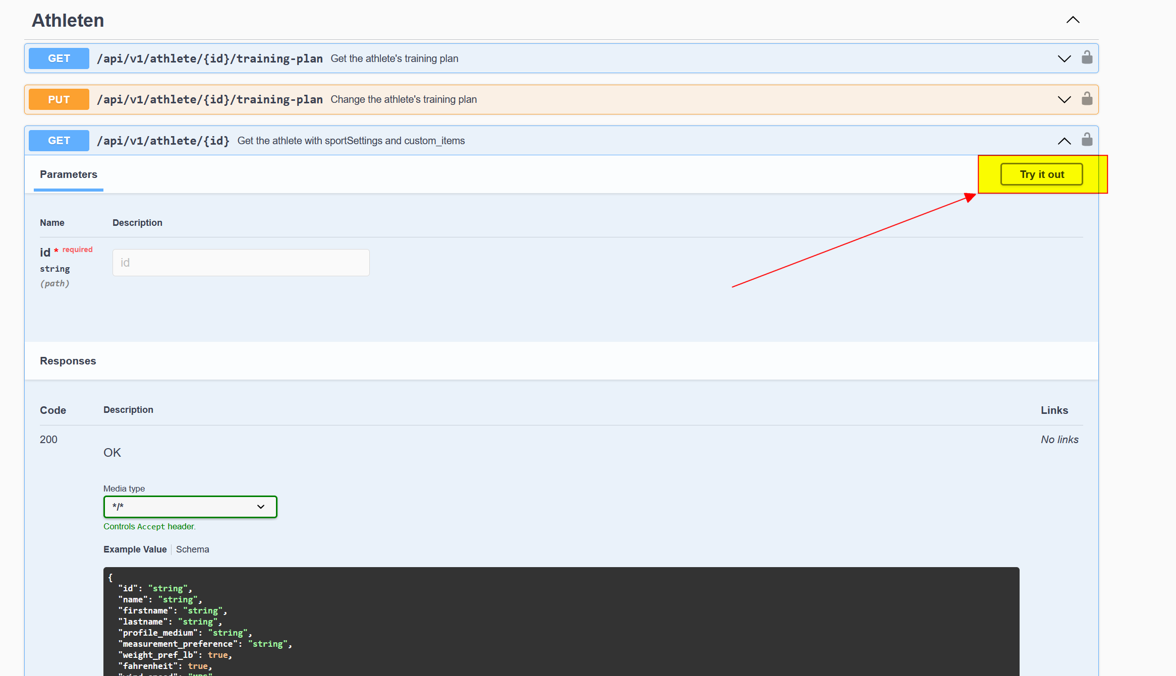

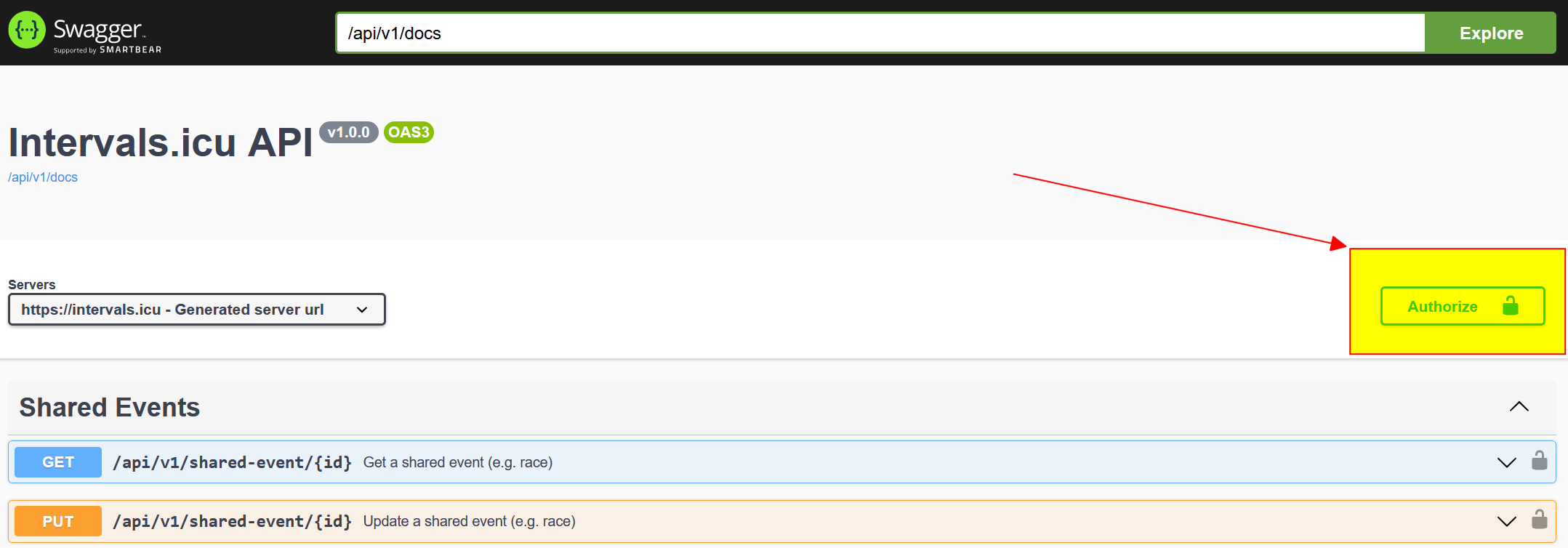

You already tried with the Swagger Tool?
and then try one of the Endpoints

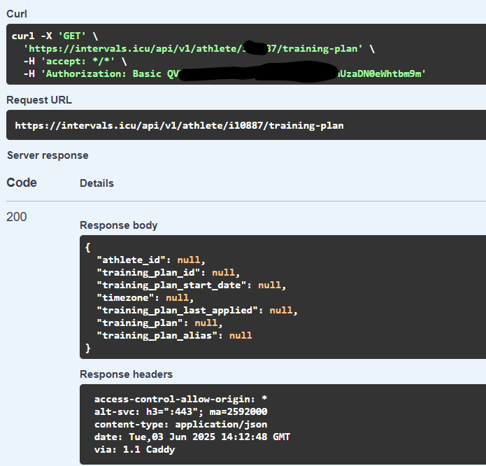

Works fine for me with the Swagger tool as per the instructions @Andreas_Schnederle-W posted above.
PS: I don’t have a plan and the response indicates ‘null’ without errors.
