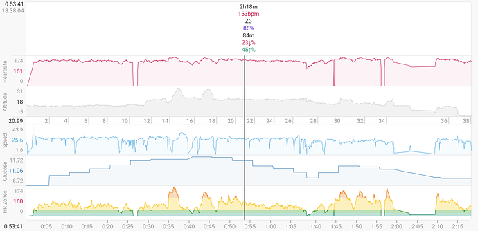

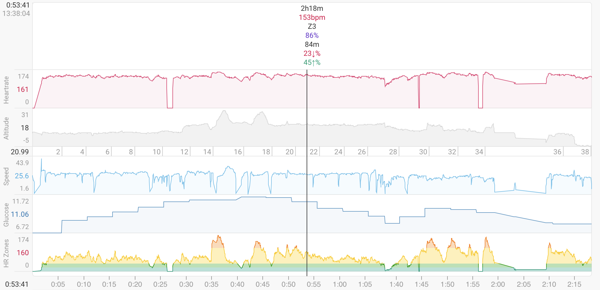

I connect my FSL2 to xDrip4iOS (important here is to activate your FGM or CGM with NFC normally, but disallow bluetooth connection in whatever glucose monitor app you are using so that the official app doesn’t compete with a 3rd party app) via bluetooth. I can still use NFC to update 8h readings so that my healthcare provider can see what’s happening.
I’ve linked xDrip to nightscout via an access token so that all data is transferred there. In nightscout you can make another access token for e.g. a garmin device with a CGM datafield, so that nightscout data is transmitted to the garmin device. To emphasise, this system only works when I have my phone to actually read the CGM data and have an internet connection for this loop to properly function. Depending on which CGM you use, there will be specific workarounds to transfer to Nightscout such as what works for me described above, but for Dexcom you can apparently also use the sharing app (i.e. make a “follower”) which transmits data.
Garmin automatically logs the CGM data once you have the datafield connected to an activity, and this is shown in your garmin connect environment, and should also be automatically transferred to intervals. You do have to select “Blood glucose” in the “Charts” at the activity to show it on intervals. I haven’t found a way to integrate nightscout into intervals directly, I guess it should technically be possible as both API are public.

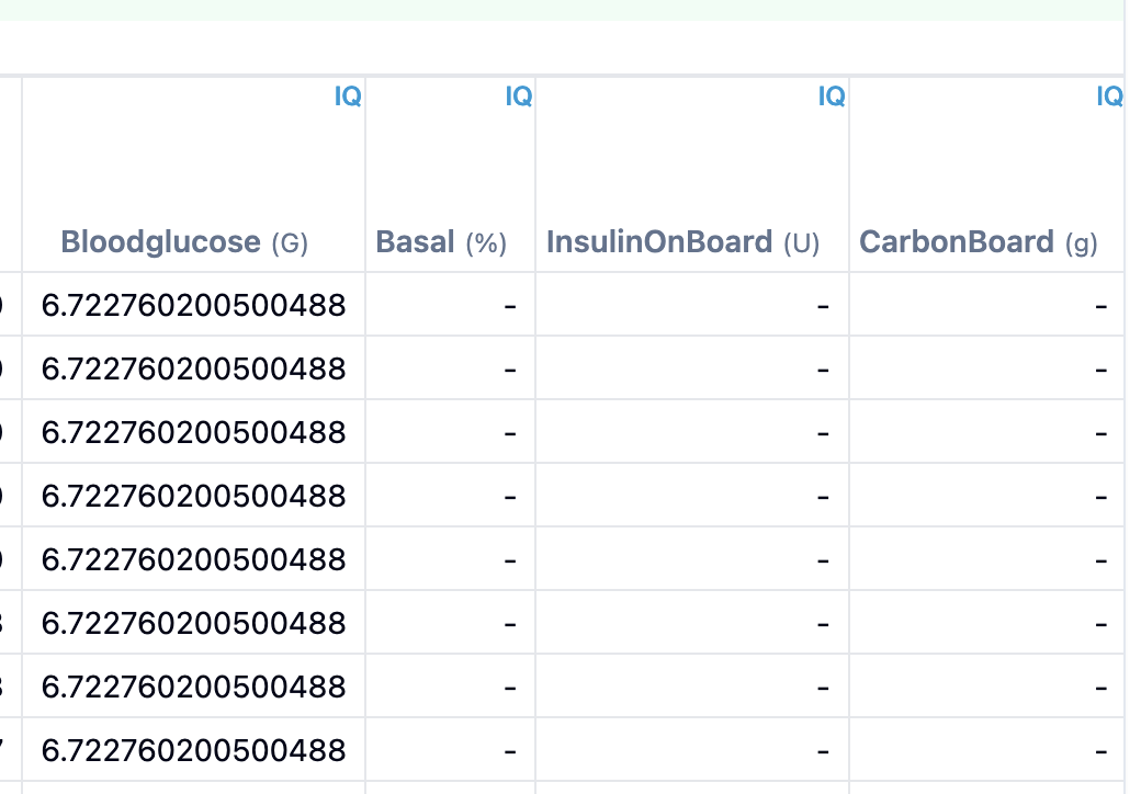

On the garmin side the BG, IOB and COB can be shown as well though I haven’t gotten around to checking why they’re not showing. They’re all in the original FIT file (see below).

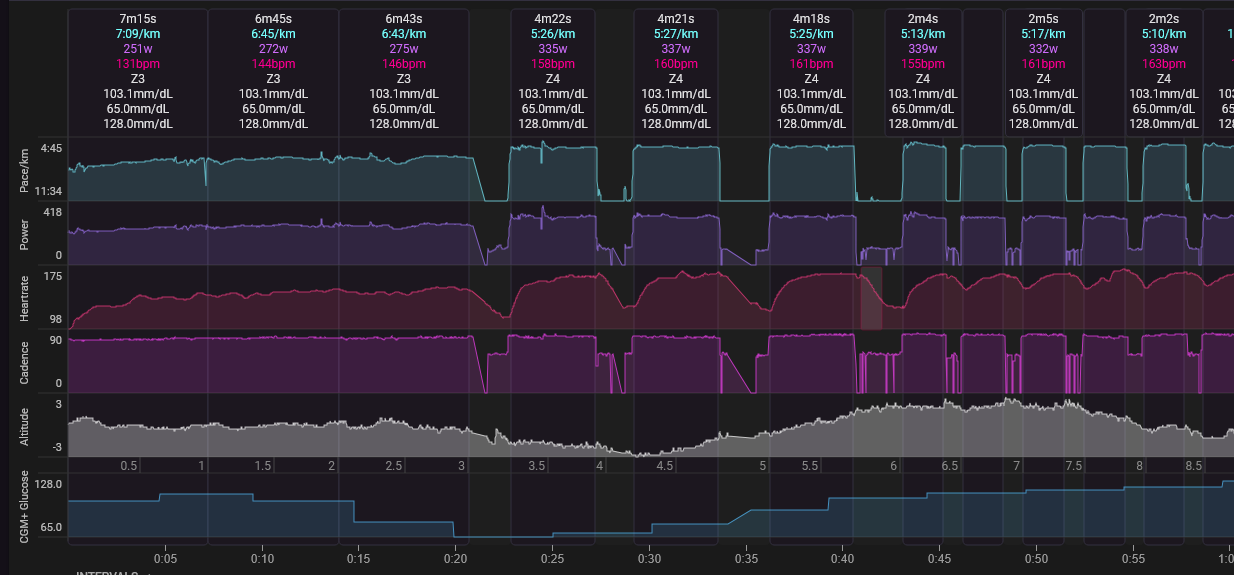

Public stream/fields for the Connect IQ CGM+ data field
If you use the CGM+ Connect IQ data field for glucose tracking, I’ve published a stream and a few fields to pull that data into Intervals.icu:
Stream: CGMGlucose — record-level glucose trace (mg/dL)
Activity fields: CGMGlucoseAvg, CGMGlucoseMin, CGMGlucoseMax
Interval field: CGMGlucoseLapAvg
All public.
