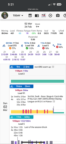

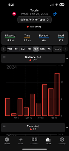

App looks great so far, much faster than adding to my compare report in the web app; however, I’m seeing an issue. I dual record most events, in intervals.icu I select to ignore the distance, hr, pace, etc from the second recording as appropriate. On runs for example I leave the power active from my watch, bike rides the gearing data from my watch as well. Anyway I’m really looking for a nice way to show my running distance progress and in your app it is including the distance from events I’ve told the web app to ignore distance from.
Interesting! I was just looking at the API documentation and I do see flags that sound like this purpose: icu_ignore_time, icu_ignore_power, icu_ignore_hr, icu_ignore_velocity, icu_ignore_pace, and a structure for icu_ignore_parts. I do not see anything for distance, but suspect it’s using the time flag for both.
If you can confirm that this is the option you’re using, I should be able to pull that into the app and use it as part of the totals time and distance calculations. I also believe this is the only ignore option that should be taken into account on the totals screen, but correct me if I’m wrong.
That sounds right, except you also have elevation on the totals page and there isn’t an explicit ignore for it. The main one says time, distance, load and should likely include elevation.
That makes sense. I was experimenting with some of my data and I see form changing when I have it turned on. I notice the label mentions load as well, so I’ll zero that out if it’s enabled too.
I’m going to add some visual indicators to the activity list and activity details if the ignore flag is enabled.
This was actually pretty easy to incorporate. If everything above sounds right I can get v1.1.2 in the release pipeline today. I wasn’t aware of this feature before, so it’s nice to learn something new about intervals too.

Looks great now, thanks! I see the yellow activity icon for ignored data too in the activity list. I’m otherwise struggling with what to do with that tab. It would be cool if I could use this to apply the ignores.
